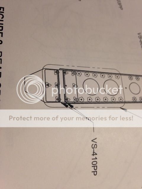

I am not sure that this is a "gotcha" or not. But I think that the seat ribs in the finishing kit have changed. Section 55 shows that the 3/4" holes for the stick wire bundle have a rounded notch out so that the rectangular connector and be pushed through (check out Van's revision of plans and the notch is clearly there). I am not sure when that changed. It is clearly not in any of the plan revisions that I have looked at so far. Section 25, 28, and 29 all show the ribs with round 3/4" holes. Maybe I missed where it is called out in the plans to make this notch out. Also, the 3/4" holes in the tunnel sides F-01451 are not notched.
Also, install all the snap bushings before running the wire harness. I put in the WH on one side with out doing this and boy is it a pain to do after it is in place.
...Section 25, 28, and 29 all show the ribs with round 3/4" holes. Maybe I missed where it is called out in the plans to make this notch out. Also, the 3/4" holes in the tunnel sides F-01451 are not notched.
I haven't checked since I built to see if they added the notch to the plans. In my case, I received a piece of paper (not a plan revision page) with the fuselage kit that had a drawing with instructions to add the notch.
I don't recall the time frame of when I ordered the fuselage kit, but it had been out awhile before I finished up the empennage kit and the wing kit. The single sheet drawing I received may not have been in the earliest deliveries of the fuselage kit.
That said, this is the only part of the Van's wiring kit that I ended up replacing. I found the connector that goes through this hole to be too vulnerable to working. It is a mini molex that really needs to be held rigidly or the pins can work loose and come out of the connector. I replaced these connections with D subs after that happened on one of the sticks (long before first flight).
In the end, you can just remove the connector and feed the stick wiring through the unmodified hole. Don't try removing the pins and reinserting them in the mini molex. Per Molex specs, these are one shot pins, they are not meant to be removed and reinserted.

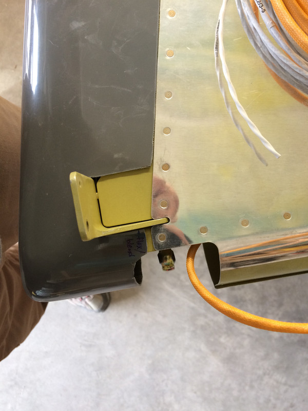

12-02 Rudder bottom Fairing

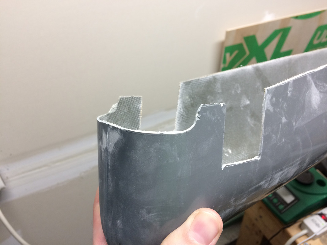

Page 12-02 Step 2 states "Drill #30 two holes on each side of the R-911 Rudder Bottom Fairing as shown in Figure 2. Take care to keep the holes
within the area defined by the scribe line. Remove the area up to the scribe line on the rudder bottom fairing as shown in Figure 2".
Pay attention to figure 2 as it shows a straight cut along the top of the fiberglass within the scribe line. DO NOT FOLLOW THE SCRIBE LINE AROUND THE FRONT OF THE RUDDER FAIRING. If you do so then you will end up with a funky looking fairing and realize you just screwed up.
I think once you finish the rudder , you will find that you would not be able to install it on the vertical stabilizer if it didn't have that funky shape.....
12-02
I went back out and fit the fiberglass to the rudder and the cutout in front actually fits pretty nice. I had to clean up the edges a bit since the scribe line was not equal on each side and the front area had a distinct slant, but once trimmed significantly and fitted to my rudder it looks a bit better.
Lets change this plan gotcha to:
"be weary of the scribe lines symmetry and ensure you cut short before trimming to the specific fit of your rudder. Figure 2 does not match the scribe line on the R-911 Rudder fairing."
I'll add some Flox to fill the gap in front of the rudder horn once the temperatures here warm up a bit.

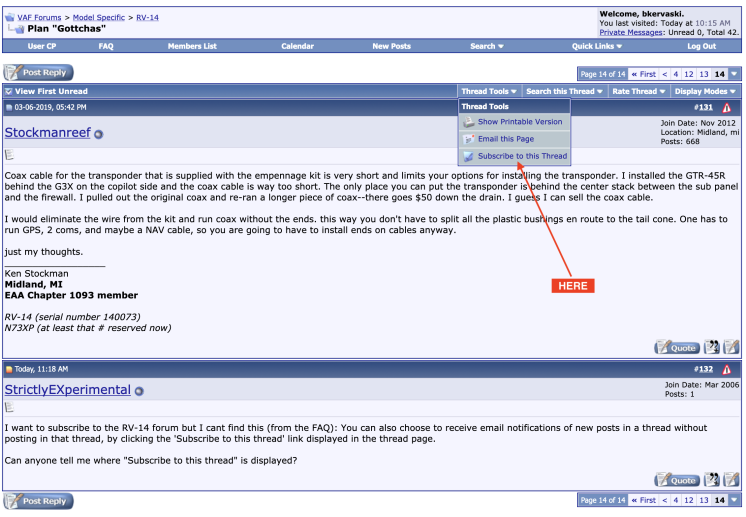

Coax cable for the transponder that is supplied with the empennage kit is very short and limits your options for installing the transponder. I installed the GTR-45R behind the G3X on the copilot side and the coax cable is way too short. The only place you can put the transponder is behind the center stack between the sub panel and the firewall. I pulled out the original coax and re-ran a longer piece of coax--there goes $50 down the drain. I guess I can sell the coax cable.
I would eliminate the wire from the kit and run coax without the ends. this way you don't have to split all the plastic bushings en route to the tail cone. One has to run GPS, 2 coms, and maybe a NAV cable, so you are going to have to install ends on cables anyway.
just my thoughts.
I want to subscribe to the RV-14 forum but I cant find this (from the FAQ): You can also choose to receive email notifications of new posts in a thread without posting in that thread, by clicking the 'Subscribe to this thread' link displayed in the thread page.
Can anyone tell me where "Subscribe to this thread" is displayed?

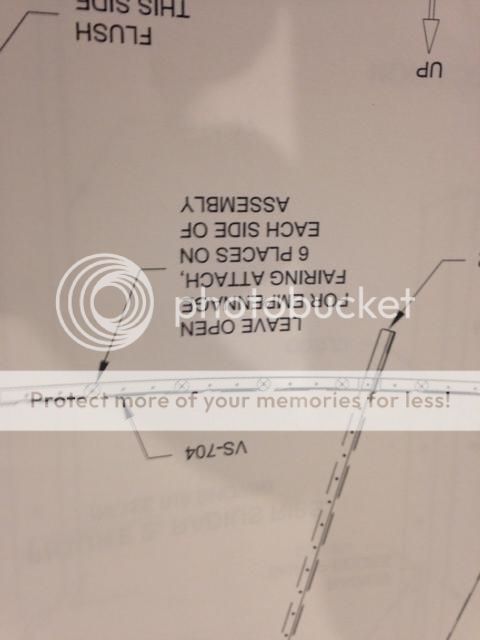

Rudder tip fairing attachment
I was looking ahead and studying the attachment of the rudder tip fairing. Noticed on page 12-05 that 18 CS4-4 rivets are called for. My rudder has only 16 rivet holes so I contacted Van's about the discrepancy. Seems that, when preparing the rudder skins prior to assembly, an additional rivet hole is supposed to be drilled on each rudder skin offset on either side since there won't be room for the two rivets back to back. Since the two skins are identical parts prior to bending the forward end of the balance tab, the holes can't be punched along with the rest. As I was told, this is done in the RV-7 and RV-9 rudder (the latter shown in the attached drawing).
There's probably not much consequence to the missing holes. In my case, I intend to use Hysol in conjunction with the rivets to attach the fairing. It would probably also be possible to drill the holes after rudder assembly but I could not find any way to dimple them.
Hi Ray,
That’s interesting - mine had 9 holes a side, the aft most one was drilled to #30 and dimpled at page 07-04 step 2 ready for countersinking they fairing at a later date.
EDIT: I can’t count. Mine had 8 holes as well. See other post above.
Ahh, it may be that the plans have been revised and I missed that.
EDIT: Just checked. That's not it. Those two holes (one each side) were the last of 8 each side on mine, I'm pretty sure. I remember doing that step. What I was told was that a new hole needed to be drilled in each side, each staggered from the other to allow room for the rivets to go besides each other on the inside.
Well that’s interesting! I just checked as well and I only have 8 holes on each side, not 9 as you mentioned! I don’t recall there being any step mentioned about drilling another hole and in my case it would involve drilling out all the rivets to get another one in there. I wonder if I missed something? On page 7-04 it gets you to drill and dimple the 8th hole from the front because you can’t really dimple it later. Not sure how I would dimple one in-situ further aft where the skins are even closer together.
Here is a photo is my installed rudder fairing - only 8 rivets on each side.
https://tasrv14.blogspot.com/2020/04/12-empennage-fairings-complete.html?m=1#postLightBox-14
Thanks for your pickup - I’m keen to know what the outcome is now and if I have to remove my tip fairing.
I certainly wouldn't think this is a show stopper. But it's curious that the instruction didn't make it into the manual.

I've been flying for 3 years so it's about time I add to this thread. I'm finally putting the gear fairings together. On page 46B-09 in the tail dragger section, we are told:
Step 2: Match-Drill #40 the six nutplate rivet holes into the wheel fairings.
Step 4: Rivet the three nutplates to the wheel fairing front as shown in Figure 1.
Step 2 should say "wheel fairing aft" instead of "wheel fairings." Step 4 should say "aft" instead of "front."
Watch page 09-23, rev1 has the steps out of order, should be 2 after 3 and 7 after 8. At least that's how I did it and had access for the top inboard elevator skin and skin rivets. If you close that up, it looks like it'd be hard to get to. I've added a comment to the wiki.
